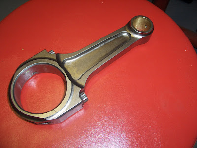

Total length is 127,5mm and 34mm of them goes in the block
cylinders = AA and piston is JE 432g
picture=http://bp1.blogger.com/_PK72ALI-_i0/R0msNAwGLHI/AAAAAAAAAyQ/7EVMuTr1t2Q/s400/HPIM1469.JPG
John, i have the same cylinder/piston combo with 80 mm c/w DPR crank, chevy journals and H-Beam Eagle rods.
Would the stroke be too much ? (Piston pulled out of cylinder?). How much clearancing would i have to do
inside the new T4 case.
Would you, or some other T4 head know where to get cyl. spacers and copper headshims Huh
Thank you very much,
Harry

« Reply #93 on: October 17, 2010, 12:41:48 pm »
Harry
Hi
I use a 86mm crank so I cant see why a 80mm wont work
I think you need to put your stuff in youre block and look
A friend of mine made mine spacers
John

What rods are you using to get the necessary clearance to that big cam?
bang
Posts: 671
« Reply #103 on: November 16, 2010, 09:09:20 am »
john is using cunningham rods.
Udo
Posts: 2078
« Reply #104 on: November 16, 2010, 12:34:10 pm »
I think the cunningham are the only ones you can use on 86 stroke. up to 82 mm the new Pauters work well

Elnef
Posts: 581
« Reply #105 on: November 16, 2010, 16:24:35 pm »
any dyno numbers from today?
280hp and 308nm with fanbelt on
Hi
Have you ever tried a smaller exaust ? It looks very big , special the muffler
Why is the car so heavy Huh
Udo
I belive its heavy because of all the tube inside the car its an old pan car there is modified to a tube chasis car with ladderbars all tube in mild steel
I dont know what to do now maybe build it back to a pan car with new rollcage in cro molly
Is 2" header and 3" mufler to big for a 2979ccm ?
Yes I use cunningham rods
http://4.bp.blogspot.com/_PK72ALI-_i0/R5xZ07JCnwI/AAAAAAAAA2o/n03zXQujzSY/s400/HPIM1518.JPG
John

« Reply #107 on: November 21, 2010, 01:45:53 am »
Udo
Actually the new Pauter stroker rods clear an 86mm stroke. Thats about 2.870" outside dia on the big end for a 2.0" Chevy/Buick jrl.
And these rods have a 5.800" - 147.32mm C to C
Richard
