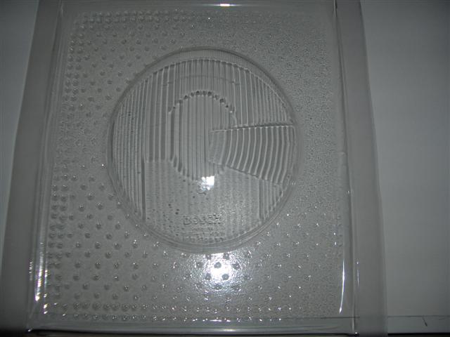

November 14, 2009, 19:17:25 pm »
A bit of d.i.y...0,6 mm. polycarbonat lenses...app.40 gram...made over a casting(and not over the glass !),so they will fit inside the chrome rim like the original lenses
Cheers from Griebel

Quote from: Griebel on November 14, 2009, 19:17:25 pm
A bit of d.i.y. -0,6 mm. polycarbonat lenses...app.40 gram...made over a casting(and not over the glass !),so they will fit inside the chrome rim like the original lenses
Planning on making more?
This was my very first "pull", but yes,-I'm planning to make more....Casting a model of the old symetric lenses too.....
