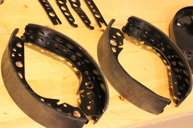

Bus reservoir has to be lighter than the stock set up.
Finished brake parts-

So much paint, it must make the parts make weigh in heavier than before the drilling
This really is my favourite thread ever! Don't stop the drilling!
Wünderwaffe are Go!

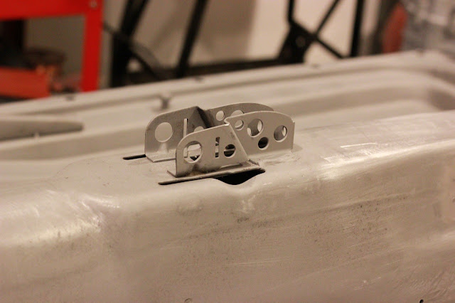

did you drill out the e-brake pivot pin yet?
Now guess which one weighs 24g, and which one weighs 8g?

Bruce
Posts: 1424
Re: The weight saving thread
Reply #403 on:
January 03, 2011, 06:39:14 am »
Quote from: Chris W on January 03, 2011, 06:33:05 am
Is one a repop?
You could say that. Yesterday I "repop'd" them from aluminium.

Nice drop of madness you have going on there Bruce!
Great quality work as ever too.

Quote from: Bruce on January 03, 2011, 06:39:14 am
Is one a repop?
Those are super nice Bruce ... you gonna make more to sell?
Tom

Very nice work Bruce!
Think they are lighter than the billet ones out there? They sure look nicer.

I'm sure they are lighter. Mine are 2mm thick everywhere. Just like stock. The billet type ones are thicker.
I didn't make them to be lighter than the billet ones. I just don't like any of the billet stuff you can buy.

Hi Bruce. Nice brackets! Out of interest, how did you press the swages into them? Very trick, did you make some kind of former? Regards, Matt

Quote from: All Torque on January 05, 2011, 10:34:35 am
VW did.
After I cut out the Al from 2mm sheet and made the two bends, I put a stock steel bracket on each side, then squished them together. It's not ideal because there's no allowance for the thickness of the material, but it does kinda work.

Ah... Good thinking Bruce. I like your style
