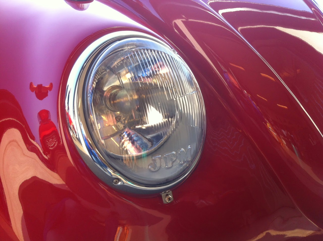

Quote from: Griebel on October 19, 2014, 01:50:43 am
I wonder if these headlight lenses are available, could use a pair.....
Pekka

February 26, 2017, 18:10:32 pm »
A Danish(or Belgian) guy made a pair for my bus..think his name was Griebel..nice guy..

Nice hinges, are you making any more?
Also, any body have Carsten Griebel contact details? I have no headlight lenses so may as well go for the lighter option, can tey come without the jpm logo?
