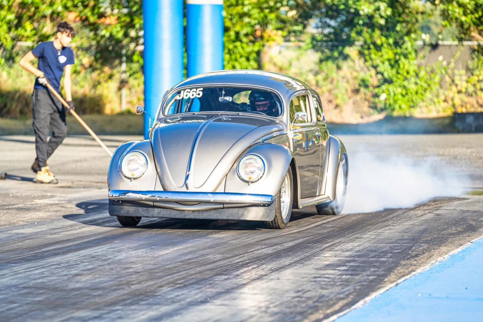

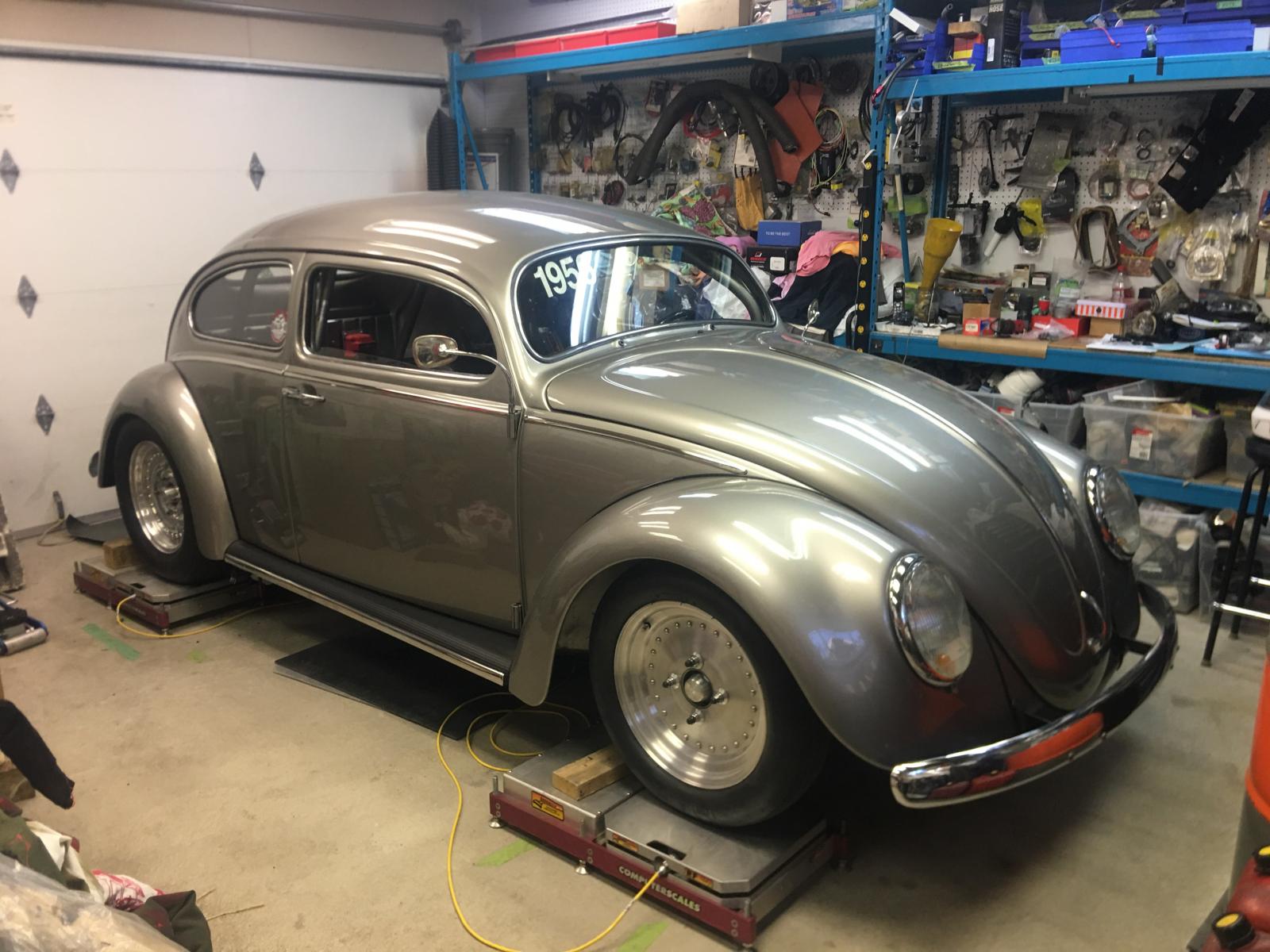

Posts: 23
Re: Wings/aerofoils Are they really needed? and if so when?
Reply #369 on:
August 28, 2023, 00:30:46 am »
This was a great topic with lots of terrific information.
I recently build and tested a front air-dam. Easy to remove and install .
When I was staging the car I found it was tripping the staging bulbs quickly with the air-dam, so I will need to trim
A bit off the bottom.
One thing I don’t have on the air-dam on the bottom
Edge which I see many having is a fwd lip 90 deg to the air-dam that appears to be about
1” in length .
Should I add that once I trim the bottom 1/2”. I take it the idea is to not allow any air to roll under
The air dam . Any input always appreciated
Last Edit: August 28, 2023, 20:54:04 pm by jim martin
Reply #370 on:
August 30, 2023, 17:51:58 pm »
I think the lip helps in 2 ways, 1st to stop air roll under off the airdam and 2 to add some strength along edge of airdam but this is dependant on how it is attached.
The regs most of places i have raced at require 3inches ground clearance minimum on front of car, and beams are usually about 1.6-2inches off ground so something must be pretty low to flicker beams on?
cheers Richie

jim martin
Posts: 23
Reply #372 on:
August 31, 2023, 05:22:35 am »
Thanks for the input.
Now that I have a prototype and even better the pattern,
I will make another air-dam and add the forward lower lip,
Makes total sense for not allowing air to easily roll off and under the air-dam and add rigidity.
- I found out what’s triggering the staging lights .
After my burnout I come out fast and Finnish hard on brakes .
This ends up loading the frt suspension and causing it to drop .
Now my air-dam is lower by about 1 to 1.5 inches.
I tested The frt end and yep if i push down on the frt end it drops but does not
Spring back up , but if I lift the frt end it comes up easily .
I’ve regreased the beam , but figured this is due to the urethane bushings .
Maybe time for a needle bearing beam
