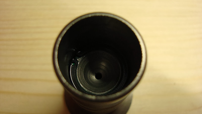

CB lightweight lifters with loctited internal snap ring

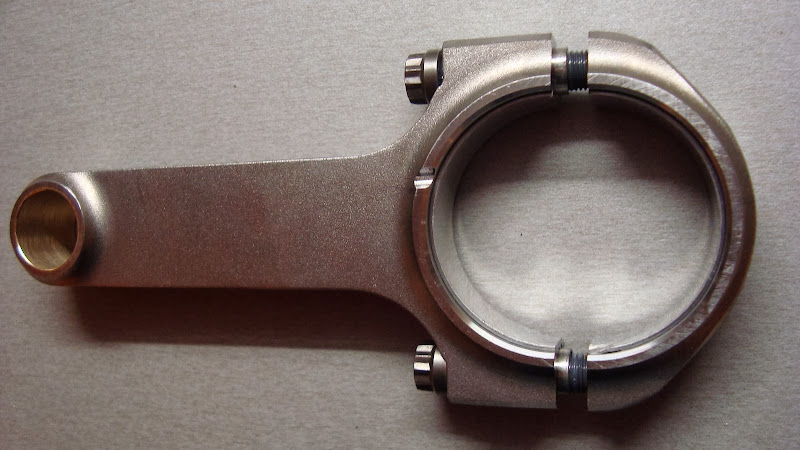

rods - will use balanced H beams and considering notching them for squirting oil on the underside of pistons to help cooling. Unfortunately I wasn´t aware of engine case squirters mod when ordering my case

I already have 5.4 rods with VW journals so that is what I have to work with. Currently I´m running a stock singleport 1500 with Kadrons, Scat linkage and 019 distributor, along with Bugpack header. I´ll add 1.4 rockers for the next season untill my big engine will be ready.

The shorter rod will work better with a heavy car. Good choice.

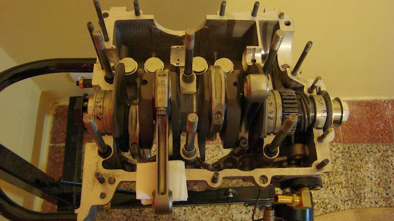

Now I´m mocking up the crank and I have a problem. Crank is a generic chinese 82mm forged crank and I´m using an installation kit from Bugpack which includes two woodruff keys for crank gears. I can hardly press them in to their keyways with my hand and I dont want to force them in BFH style. Am I suposed to heat the crank, freeze the keys for better installation, or can I
lightly
sand the keys for an exact press-in fit? Thanks.

February 04, 2009, 16:48:56 pm »
if i'm correct you're supposed to heat the gears.

February 04, 2009, 17:48:44 pm »
i sanded one side of the keys just enough so i could tap them in with a hammer

February 04, 2009, 20:44:47 pm »
I measured the keyways and the keys and they are out for 0.2 mm! Talk about press fit
I have to sand them down.

February 04, 2009, 20:46:38 pm »
I polish lightly (with 400 wet/dry) only if they are REALLY tight going in. I use a small nylon hammer to drive them in. Be careful some aftermarket keys are tight and sometimes they will "peel" and you'll get a burr that sheds off key after you drive it in. Could cause a (big) problem.
Yes the gears have to be heated to install. If the cam gear goes on "easy" without heating, you've got BIG trouble.

February 05, 2009, 08:41:36 am »
To heat the gear up I use a piece of 1/4" steel plate on the gas hob in the kitchen! drop the gear on that and it heats up without any direct contact with the flame. I've also heard of people using the hotplate of a coffee maker - I've got one of those too!

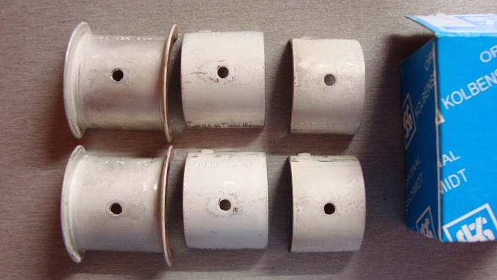

Soo gentlemen..no I have brand new set of KS bearings and on the thrust set of bearings there are no tangs to fix the position of the shell in the case half.
-should I try to create one
-should i leave it as it is?
-should I leave it as it is and use thin smear of Loctite bearing retainer between shell and case half?
Thanks,

Peter
Posts: 1301
Re: My 2276 dream
February 11, 2009, 22:37:19 pm »
just install them,
no need for glue

February 11, 2009, 22:42:36 pm »
That's a "Oops" on the cam bearings.
Yes, you need to create a "tang" on one of the thrust bearings.
Sounds like you are a handy guy, so this shouldn't be too much of an issue to handle yourself with some home made tools for the job.

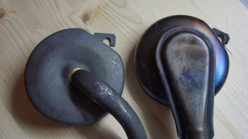

tossed away brazilian oil suction tube, replaced with german steel
CB lifters loctited
H beam notched rod

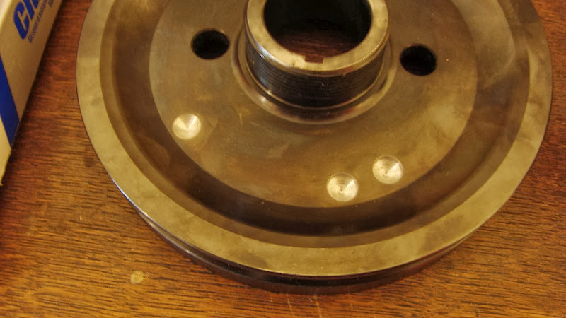

CB equalizer balanced (out for 4 grams, Cr_mo flywheel was out for 6 grams and 4340 82 mm crank was out for another 6 grams)
