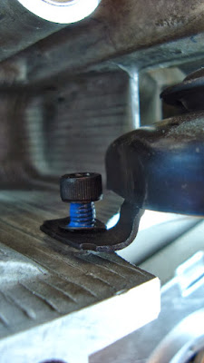

Reply #79 on:
June 02, 2009, 14:49:43 pm »
Zvonimir, I received my heads yesterday (!) so I only kinda mocked it up to take a new breath and find power (didn´t touched the engine for one month waiting for the heads) so valve geometry fun is ahead!
No problems with Scat sump and very easy to mount with some mods follow my pic:
I used Scat delivered bolts for mounting the sump to the case but used high grade long bolt through the case where the suction bascet attaches (you have to do it when the case is split)
Last Edit: June 02, 2009, 16:21:37 pm by 181

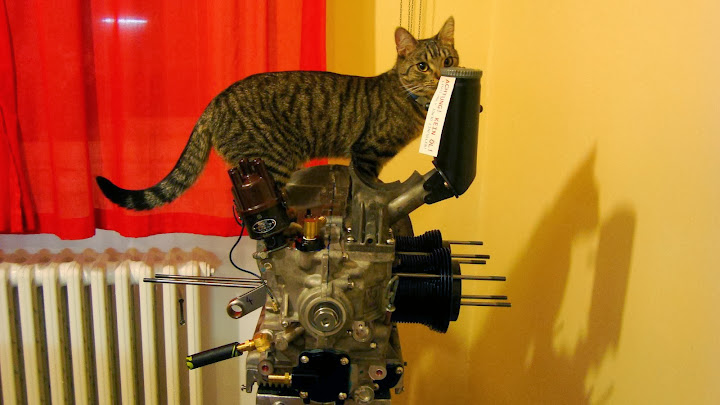

Peter
Posts: 1301
Re: 2276 internet engine kitchen build, engine builders advice welcomed!
Reply #80 on:
June 02, 2009, 16:36:43 pm »
I advice i can give:
dont let the cat come too close to the engine,
i thought i cleaned everything properly during assembly,
but when i cleaned the oberg, i found a lot of white hair!!
and there s only one guy in my house that has it:)
so watch out !
Peter
Reply #81 on:

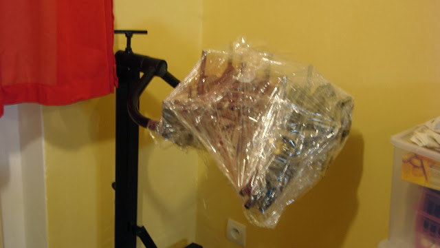

June 02, 2009, 17:04:29 pm »
Thanks Ruff, I realise there are kitty hair flying everywhere in the apartment so I keep the engine wrapped in blanket when I don´t work on it. It is time consuming but I´m anal when it is about cleanliness :-D I also clened all parts with compressed air (yes I brought my compressor to the kitchen) and I vacuum clean all parts before installation from all dust it may collect.

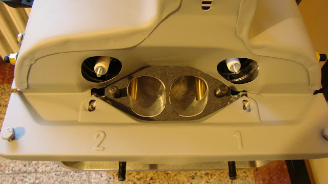

June 04, 2009, 21:40:39 pm »

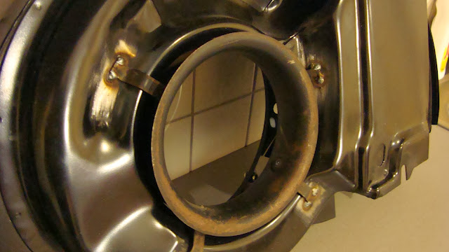

Well this is a flange of CB Big Bœuf manifold ported for Steve Tims heads. A lot of meat is left untouched.
and this is a view of right side cylinder tin (german original) untouched and unmodified.
My question is - if I transfer the shape of the original opening to the flange on the manifold and grind off excessive meat, will the manifolds give the carbs enough support and will there be anough sealing surface? I cannot bend the tin inwards because stock deflector inside is already almost touching the most outwards cooling fin on the head.

Reply #84 on:
June 04, 2009, 22:51:44 pm »
Yes I noticed that that area of the CB Big Beefs you mention is very unfinished and gives no correct seating surface for manifold nuts. I will get back with pics of finished product later. Thank you Dirk!

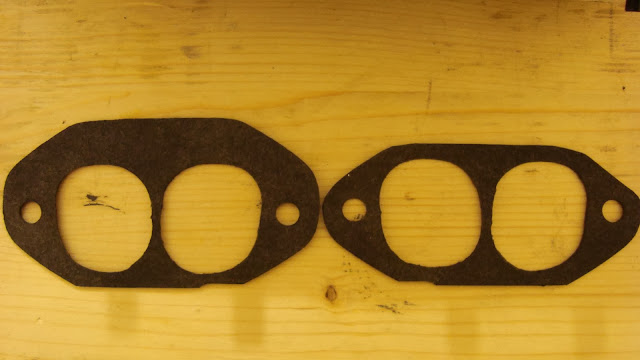

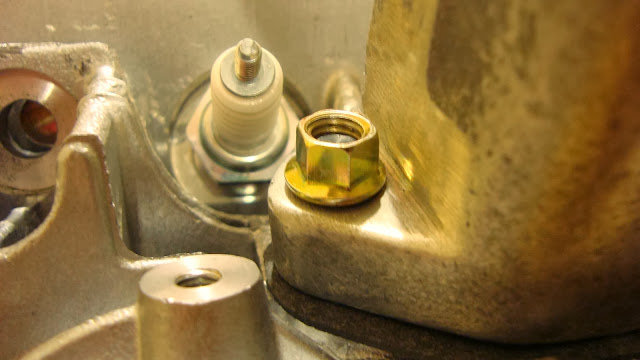

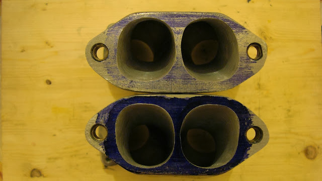

June 06, 2009, 21:48:28 pm »
I modified my big beef intakes today. Cooling is crucial for me, as the car is street driven driver, so I do not want to heavily cut and mot my upper cylinder tins. This mod allowed me to use these intakes only with some light tapping on upper cylinder tins.
this is typical intake of 043 Stage 2´s from Steve Tims.
this is intake gasket cut to shape of intake flange on the right, on the left is size and shape of CB Big Beef flange gasket
I then copied new shape to the manifold
cut, grind..beer..grind again...in fact as a final step I bolted both manifolds together, flange to flange, and grinded them together to keep the shape the same on both
and also created seating surface for my CSP intake nuts (10 mm hex 8 mm thread)

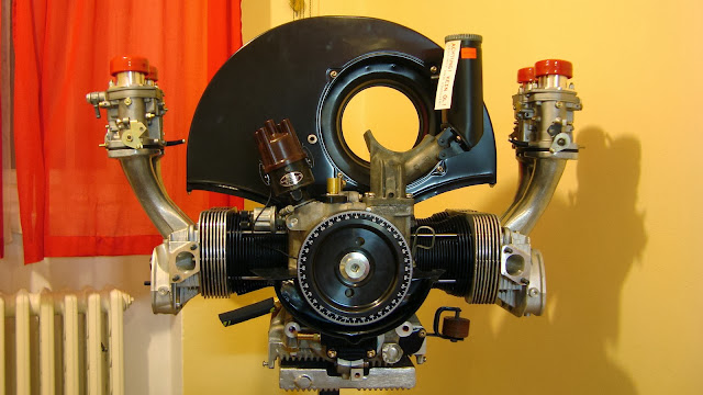

Reply #88 on:
June 09, 2009, 15:46:16 pm »
welded FI venturi ring to my Scat shroud
