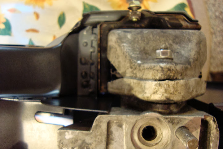

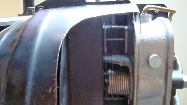

made some small progress on lower engine tin today. I started with drivers side because it is more complicated. I had to trim the sled tin because it interfered with big turn of tubing from 4th cylinder. That means the industrial tin had to be shortened for a little bit too.
Then I moved the industrial tin toward the engine so it wont interfere with number 3 J-tube and trimmed a 1/2 inch stripe of tin from the sled tin and made new holes to attach the industrial tin.
Last picture shows how much metal will be added to the industrial tin so it will end under the head.

very nice dude! but as far as i know, many people don't even run that tin, right?
what kind of pushrod tubes do you have? they look stock, but shiny
DVK ~
Re: 2276 internet engine kitchen build, engine builders advice welcomed!
Reply #96 on:
July 17, 2009, 14:14:13 pm »
these are (cough cough) EMPI (cough) stainles steel windage tubes. As I tried to stay away from EMPI as much as possible, I douldn´t find any other brand stock pushrod tubes. As I use aircooled.net alu HD pushrods, thing inside are very crowded.
I try to use as much stock tin as possible!

Quote from: 181 on July 16, 2009, 21:41:33 pm
Are these stock length pushrod tubes.

July 21, 2009, 09:09:56 am »
yes they are, I only stretched them a bit by hand. Engine is almost stock width with only 2.5mm barrell shim added on each side..

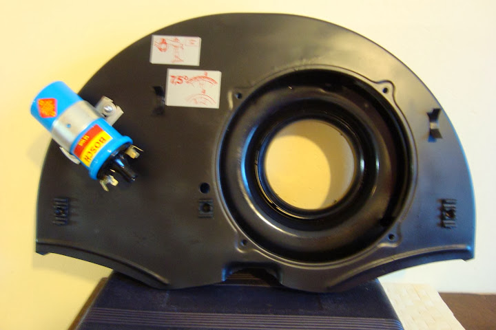

modded Scat shroud complete:
added a venturi ring, welded internal vanes to both sides of the outer skin so they won´t fell of by vibrations
made holes for stock ign. wire holders, welded tabs for holding alt. wiring
added threaded inserts for ign. coil bolts
welded and reshaped area around hoover bit to make it seal perfectly
scrubbed and painted everything
added stickers:-)

September 02, 2009, 20:03:27 pm »
Looking good my friend!
Its amazing how thorough you work!
I m sure it will perform flawlessly
You ll have great fun with it, i can assure you

September 02, 2009, 21:07:03 pm »
Thanks Peter, I enjoy being precise in this engine build.
One extra for Zvonimir:
stock original valve cover can hide 1.4 rockers on FK8 cam. I only welded on breather tube like Berg does and some gasket retaining tabs to the inside..

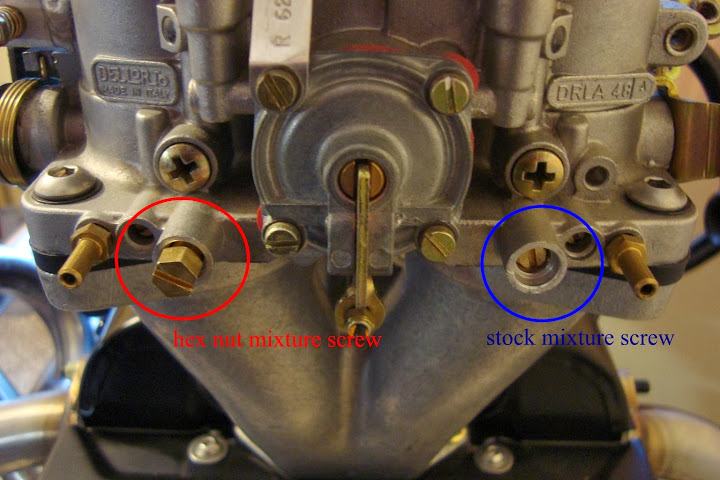

here is a neat tip for those of you running Dells. You can buy great hex nut mixture screws that can be adjusted with an opened wrench without removing carbs from the engine! They cost few bucks at Alfa1750 Ebay store and they can save a lot of time!
