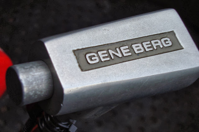

New transmission, CSP torque bars. I rehashed the transmission mounting system from CB Rhino mounts on stock cradle to stock Type 2 mounts on HD cradle to get noise to reasonable level. Mohr mount with rubber pads instead of urethane. Shift rod bushing changed for new one, shift rod coupler cleaned, inspected for wear (virtually none) and lubed (I´m using stock VW cage with urethane pads) Berg shifter dismantled, cleaned and lubed. We´ll see what it will do :-)

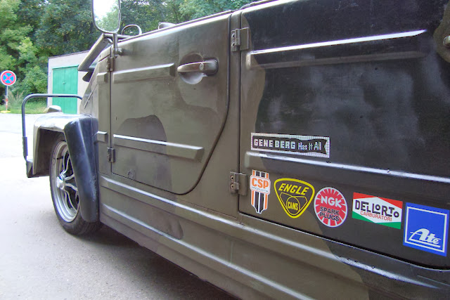

new stance..rear torsion bars reindexed up. You can see the repaint of the part of the body due to accident of previous owner (army). I had to cut, weld, paint..I consider to repaint the rest of the car next year.
Nice Bosch switch I found on old electrical device now serves for priming the 48DRLAs, Line lock control light is near the radioplayer
EBI 2014 here I come!
nice touch: RAL 6014 gelbolive paint on old Berg shigter
Parts I use
I know..oil drip. next Schadek will be o-ringed
my weapon of choice
