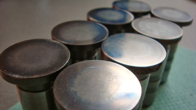

I want to ask experienced, does this wear pattern on my lifters look normal?
I had CB lifters with my FK8 cam and dual springs for approximately 5000 miles. I switched the cam for 86c with a new set of lifters but I really don´t know if it is OK to offer these for sale with the cam. That´s why I ask.
Thank you.

Thanks guys. I ended up using a new set of CB lightweight lifters with loctited internal snap rings along with 86C. The car lost its bottom a bit and the power moved up so it´s less pleasant to drive in stop and go traffic but it hauls ass when needed.
