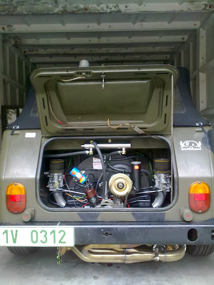

So those are todays pics of my VW Type 181 with a bit of spice..

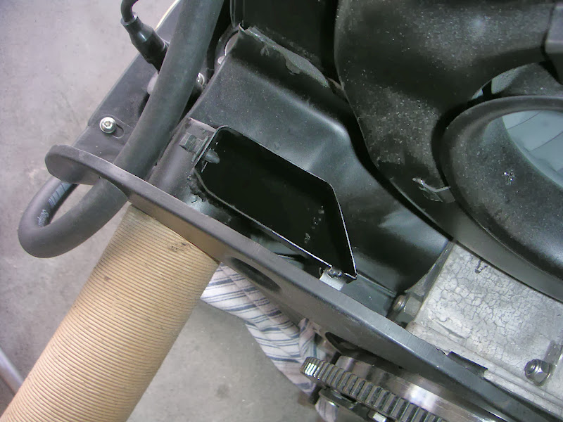

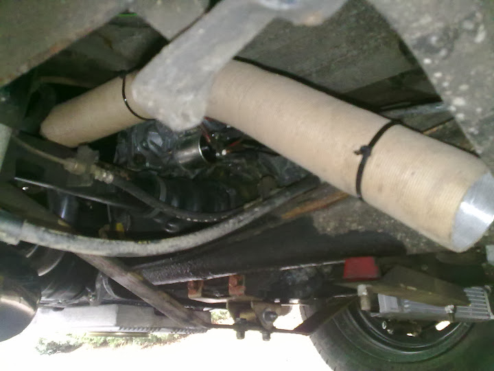

April 06, 2010, 19:43:18 pm »
cold air intake, props to my friend David
