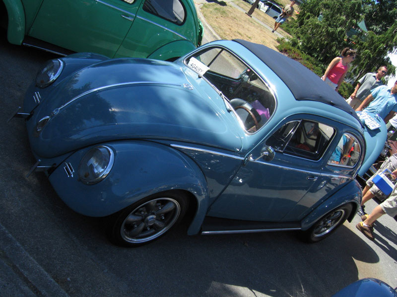

Hi Peter,
Quote
Damn that is nice! And you are doing that with a stock tranny, or is it a stonger gearbox, but with the standard ratio gears?? If it is a standard box, no fear of breaking it doing this?? Which shocks do you run up front?
I wanted to keep an original gearbox as well (at first anyway), but I as thinking of converting to IRS for several reasons:
- I have a good 1303S geabox laying here, no decent SA gearbox (so nice highway cruising)
- Handling due to IRS set-up
- Easy to change gearboxes in case you break it (really important!), you do not need to touch the brakes while changing the box
- Since I plan on driving it regularly on the streets and I want to run FUCHS wheels (4,5 and 6), the obvious choice for disks are Porsche 944 disks (super easy with these a-arms and cheap cmpared to other diskbrake converions)
I know, maybe not 100% in line with the cal-look theme, but I consider these important safety upgrades.... But I just need to check if the 6"FUCHS with 205 tyres will still fit the original fender with this IRS set-up...
The tranny is originally a single side cover IRS model that I used to run when I had converted the car to IRS. We took the gear carrier that was in that tranny and then put it in a dual cover IRS case and added the swing super diff (4.12 R&P). Right now I'm using stock axels and a poor mans posi. After seeing the wheels get off the ground I will be changing out the axels this winter to a piar of sway-a-ways. For mounts I use a mohr mid mount and my home built (Berg like) traction bar.
The Suspension on this car has always worked well at the track. I run old oil filled (cofap) shock inthe front and rear with bus snubbers in the back. The weight transfer has always been good, it just took putting a pair of slicks on to get the bite (the radials would just spin off the line)
The only change I have noticed from going IRS to swing is that corners have to be taken slower, but When I switched I also changed the front tires from 185-55-15 to 135's - so there is a pronounced understeer in corners. Although the car isn't set up to go around corners anymore the look is more than worth it.

The look is definately more then worth it! Your oval is looking hard!!
This is the same look as I'm after, but I will try it with the IRS rear end + P944 disks and 6" FUCHS/295 tyres.
As for the fronts I will use my 4,5"FUCHS + P944disks and with 145tyres on a 4" PBW narrowed beam.

You mean this pic.
we had no trouble with it. there is enough clearence.
