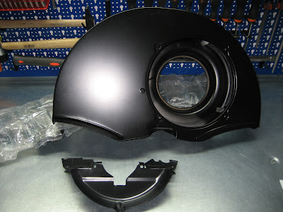

i have a 1963 vw bug and i have many doubts if the engine access windows are necessary or not.
i have a 1776cc with ida48, the window is necessary?
for me the windows are not nice to see...

It all boils down to the fan shroud and manifolds you plan to use.... tall manifolds and a 36hp or early round 40hp shroud; no windows. Short manifolds, big shroud; I'd do the windows for sure.

i use this manifolds and this fan shroud

Pretty parts.

I would say you don't need the windows..
