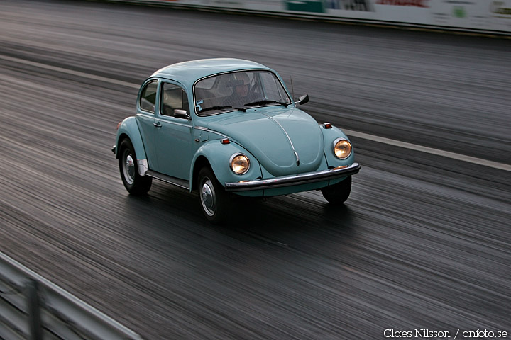

Of course there is that 1915 in Sweden used as a commuter car during summers, delivers 245 hp on the crank. Back when HP was somewhat lower the engine did a 12.76 in a full weight 1303 Super.

Quote from: JHU on March 23, 2009, 09:41:08 am
tell me more about it please.
