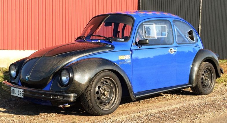

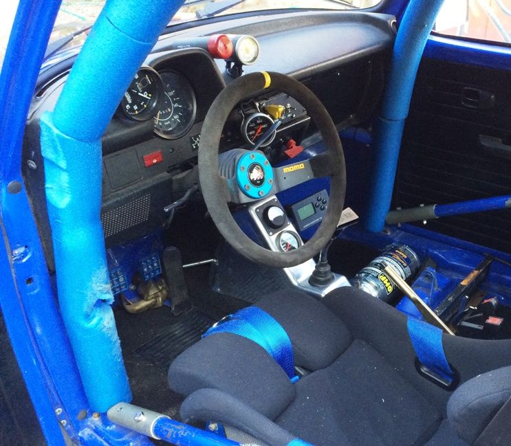

Now the engine is run in and then plenty of kilometers in and out of the workshop.
She wants more and more fuel and it is so nice to read the wideband straight in my face.
It is a bit like missing turbopressure above 4000 rpm.....yeah no turbo and not enough fuel.
I am kind of waiting for the engine to wake up.
Then I had an oil issue on a re-used AN nipple.
No!  I did not intentionally bend that bumper....... I did not even notice until I got it out of the workshop. Looks terrible and I identified it to a wrongly mounted left bracket.
Now it is fixed and tomorrow I will probably ream som mains. Lets see if she wakes up above 4000 rpm.
This one is worth gold!

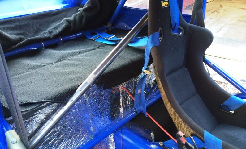

I have even sound dampened and now working on the aestethics, or rather during winter I will get the rugs in there.

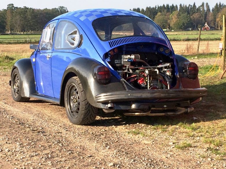

« Reply #64 on: November 30, 2014, 22:18:31 pm »
So it was beutiful weather, wife left to have fun elsewhere and I advanced the initial curve 5 degrees.
The car really woke up.
I know have 39-40 degrees total but with 104 mm bore, maybe that is normal.
More driving and dyno will tell.
Totally different to drive now.
Well, I think even coming back in the workshop, it sounds better.

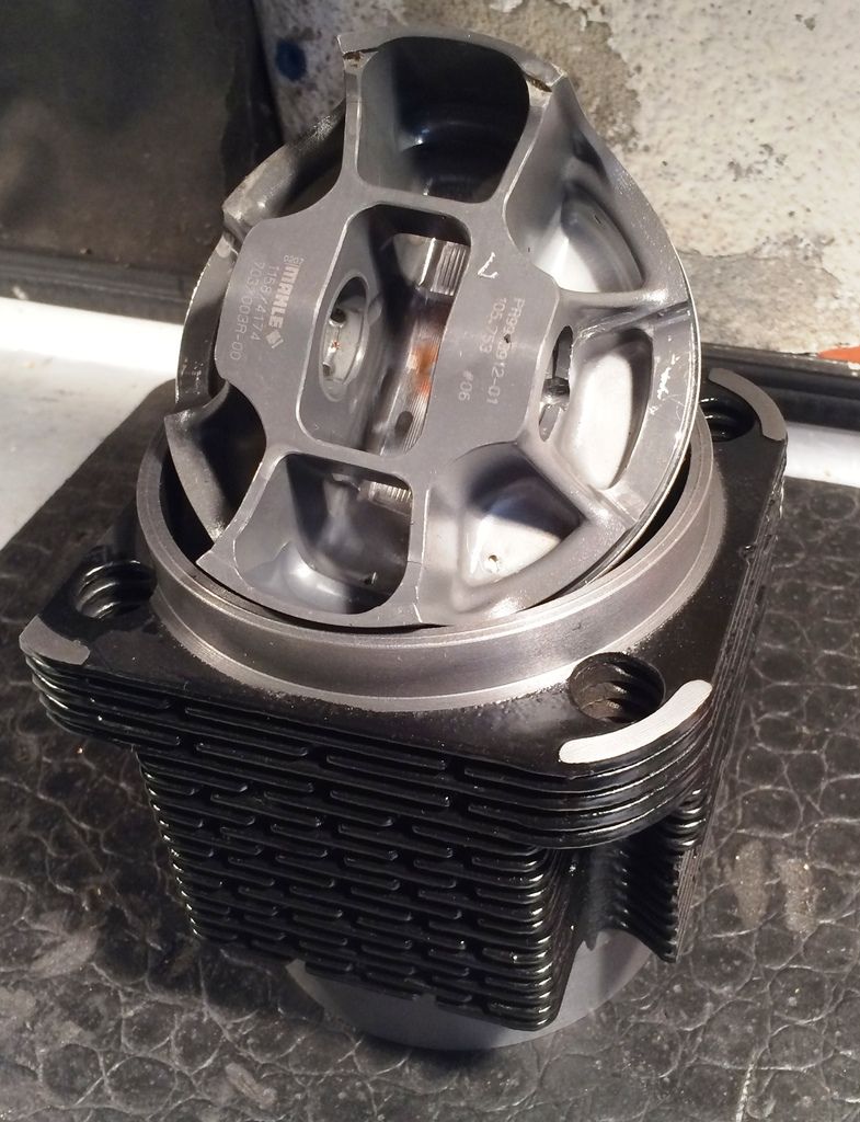

« Reply #65 on: March 04, 2016, 20:04:03 pm »
So I tried to sell the engine. Only few parts sold. So now I am building it again.
yeah I know, this is silly......but not stupid.
2495 cc with GetBackOnTrack  Deutz cylinders.
105.75 mm 2nd hand Mahle Nascar pistons.
21 mm Casidiam coated pins.
Back she goes!

« Reply #66 on: March 06, 2016, 10:00:41 am »
Who very nice, 105.75mm??  Are those the 100mm deutz cylinders or an other size?
Regards Edgar
broen messiaen
Posts: 128
« Reply #67 on: March 06, 2016, 12:45:40 pm »
they excist in 100 and 102mm but they are the same in al the other dimensions.
