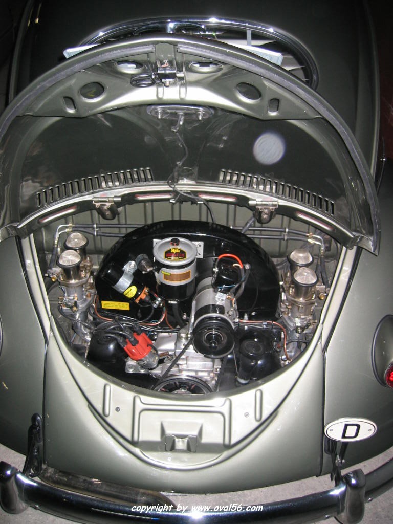

what about an modified oilfilter for breatherbox?
seen on
www.oval56.com
http://www.oval56.com/bilder/Motoransicht.JPG
http://www.oval56.com/bilder/181106%2004.jpg
or a breather box on the alternatorstand from a 356/912 model?
and maybe change the carb linkage to a berg..?

or here's another good example of cal look motor made by DOC DETAILS aka Frenchy
Re: How to make my cal Look engine 'period correct'
July 24, 2014, 20:19:38 pm »
another bice engine , is DUMPER 's engine
