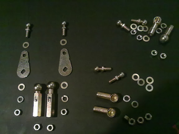

Just for pleasure I´m going to upgrade my CSP centerpush linkage with new floating ball joints.
It should 100% eliminate idle changes with warm engine. They are on the left on my pic.

My engine synced with carbtune after installation of new JKM floating linkage ball joints:

I have to say I really enjoy the car with new engine. It runs really great, it cools well, I enjoy tuning the carbs and ignition occasionaly and I really give my attention to the state of tune.
My trekker is a serious warrior now but I have to hold back and I try to not race everything I meet on the streets.
Now I consider taking it apart during winter and stepping up to 86mm crank + 86C cam because the need for power is huge. I´m taking it to chassis dyno soon as I believe it is already broken in after first 2000 miles.
I really recommend my CSP linkage mod with floating balljoints. Nothing like to stop after a quick ride and the engine fells back to nice 900 rpm idle and stays there.
Hello Jan, where can I find those JKM floating linkage ball joints? I have had same problems with idle when engine runs warm.

« Reply #231 on: July 14, 2010, 11:50:14 am »
Hey I got them directly in Jan Kreyer´s store at : http://www.jkm-tuning.com/docs/start.htm
