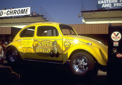

Above picture show the Super Bug on his trailer at an early Bug-in meeting! Photo by Bob HOFFELD is awesome & never seen before as usual... Note the "For sale" sign on the rear quarter panel... Were that car ended? I have no idea... but I wish it sit in my garage...

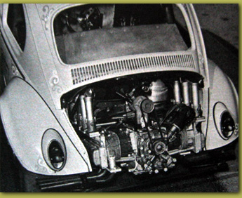

Under the hood (or trunk) is the mighty aircooled '64 Corvair engine. modifications to the powerplant give it the capabilities of producing 350 hp with a 25 per cent nitroblend.

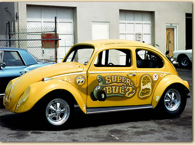

Above picture by Mike DITTY is out of this world... It perfectly captures the spirit behind that car... You have to love those shiny Cragar wheels... When was the last time you saw such a quality old picture? Thanks Mike!
Internal changes in the Corvair engine are somewhat minor. Stock pistons and rods are used along with stock valves.

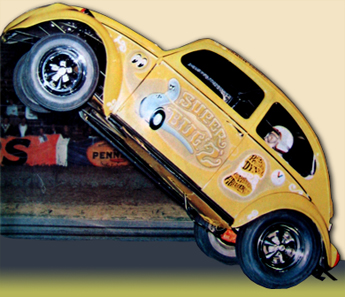

This is the picture that appeared on cover on that Popular Hot Rodding special issue! Is it a wheelstanding or what? Picture by Don GREEN. The legend quoted : "The wheelstanding Corvair-powered VW built by Dave Crash CONNERS was caught in action on a 12 second blast down the quarter".
The compression is 11 to 1 through head work by Precision Dyno company or Arcadia, California. A Moon cam operates the valve train with stock pushrods and rockers completing the valve system.

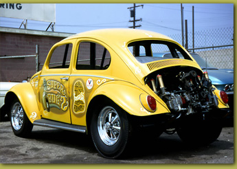

Pearlescent yellow paint job by Contemporary Fiberglass looks the part on this Mike DITTY picture!
Injectors are used as the induction system which again is the work of Precision Dyno. A stock clutch and flywheel are combined with a '64 Corvair transaxle setup and 3.70 ratio gears. Henry's made the axles to withstand the loads which are imposed on the drive train to lift the front end. Cragar wheels are used to mount the slicks and Pirelli fronts.

I thought that I never would find additional material regarding the SuperBug'2 wheelstander, but it seems I was wrong as my german friend Georg OTTO sent me a very very cool color engine picture coming from his own collection. Georg is lucky enough to have a friend that attended the Bug-in events back in the days, and he has some awesome pictures... More on that later...Thanks for sharing with us all Georg! Image is a thumbnail...
