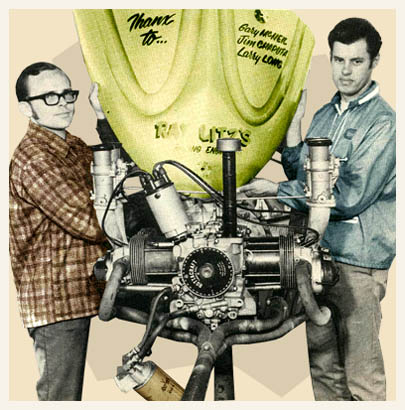

Bill hold in hands the Iguana decklid with help from Tom YONTS. Note the finless cylinders...
Work began with a '69 VW Crankcase being clearanced to accept a 82mm SPG roller bearing crank. With a roller bearing crank, the rods are stronger, thanks to a full circle forging and no parting line. With no bolts swinging around, it is also easier to fit the block without extensive hand grinding (...). You'll look in vain for any traces of fins on the barrels - there aren't any, primarily because of lack os space.(...) The pistons are built in semi-Hemi fashion to provide a 12.5:1 compression and have a dome angle of 22 degrees plus the appropriate valve reliefs. (...)

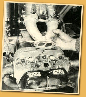

Bill uses 40mm intake valves and 34mm exhausts, makes his own chromoly seats. Intake porting is quite unusual, squared out rather than round in the section where it meets the Weber intake manifolds. The theory is a little vague but Bill tried heads with an without the squared port and found that he made more horsepower with them.

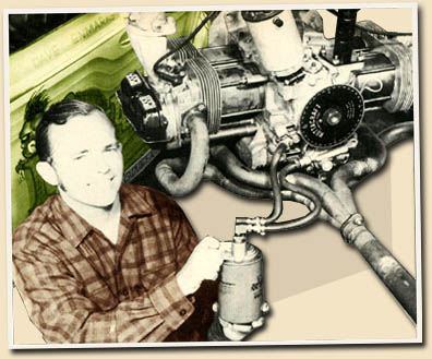

Tom shows the benefits of running a full flow oil system... Don't forget that we are in '71...
