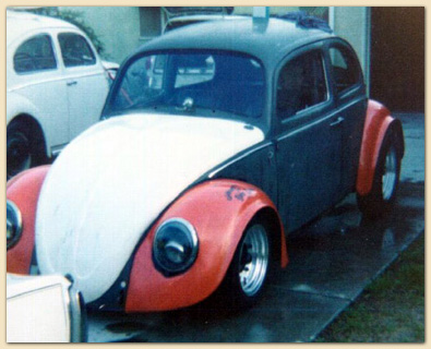

Now, is it awesome or what? Yes, this is how Italy 1 project began back in the days... Rare... and only on the Cal-look.com nostalgia corner ;) Fiberglass parts are evident on these great picture! Note that the car was retaining his trims at that time...

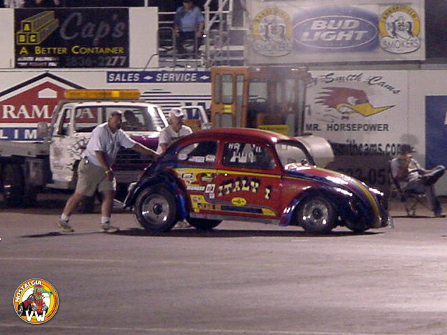

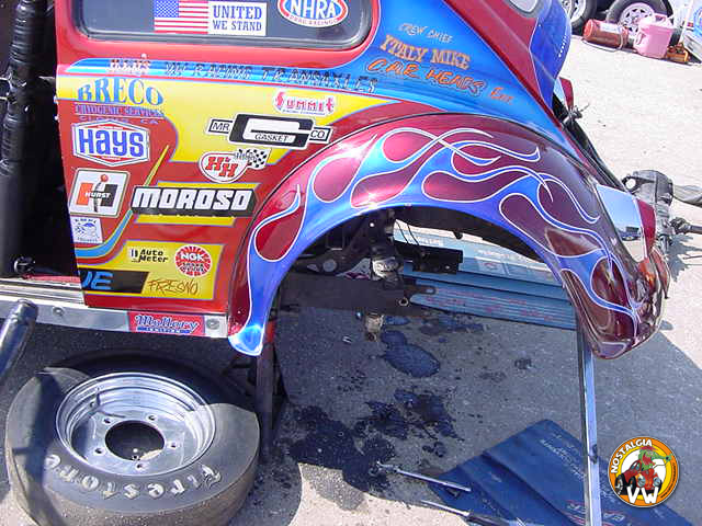

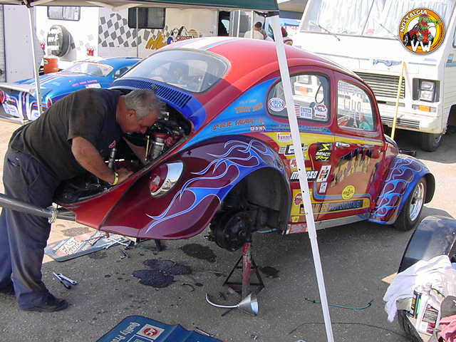

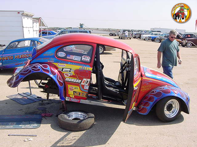

Below are some pictures by Rich CANTU of the car at the Nostalgia drags events a few years back... As you can see, it's pretty much the same and it survived the time very very well...
In fact, I guess the only changes are some more blue paint (flames...) and some stickers... Awesome piece of VW drag racing history...
