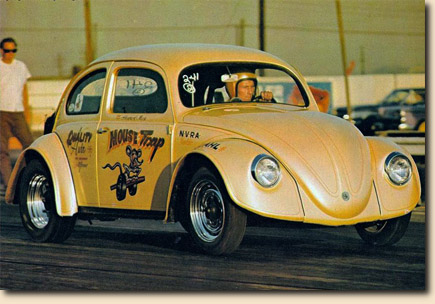

Howard MUSE is a man who has the distinction of having the world's fastest "Mouse Trap", a VW drag car which began life as a '54 sedan. The Mouse trap's builder spent 3 years testing & changing the set-up to go the e.t.'s down near, and hopefuly under, the present class record. The car's appearance all this time was completely neglected.

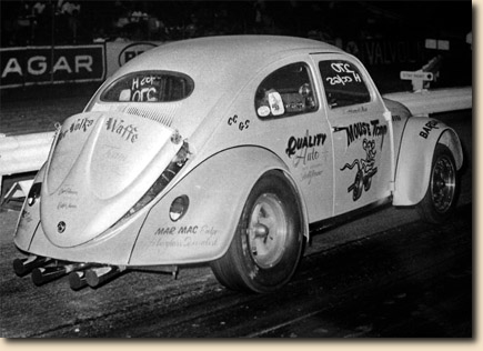

Awesome night drag racing shot by Steve REYES... Hard launch... Note that American racing rims were used at back, and the Volkswaffe Racing team signwriting on the decklid.

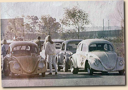

Some body work was done and a paint job added to dress it up for first Bug-in in 1968. Hood, fenders, and engine compartment cover were all replaced with lightweight fiberglass units made by Mar Mac enterprises. One look at this beautiful pearl yellow machine with its flared fenders and over-all immaculate appearance tells the story of the owner's plan to have ont of the best looking cars at the meet, in addition to going fast.For the go fast part of the car, Howard spent the last 3 years on the change it and try it method that all drag racers use in their quest for more power.

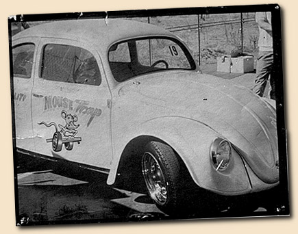

A very early picture that was posted by Pip on a forum a while back. This picture show a very early Mouse Trap (note that the Bardahl lettering was not made on the front wing).
Above picture is the best color picture of Howard Muse Mouse Trap that I know. It comes from an old US magazine drag racing pictorial. You never know what you will find in those books...

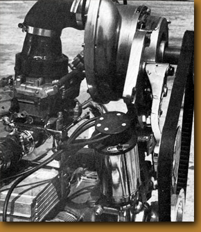

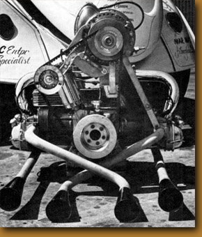

The powerplant started as a '68 VW 1500cc engine. Now it is far cry from its humble beginnings. The bore was brought up from it sstock 83mm to 88mm, with the stroke increased from 69mm to 82mm.
An SPG roller crank was fitted to the lower end of the case but, before installation, it was fitted with 8 steel pins. SPG rods are fitted with EMPI pistons and Dieves rings. A Moon 340 special cam gives 0,481 lift.
Dual port heads were selected for the engine and extensive modifications were made. The spark plug holes were welded up and new ones drilled at a different angle. Combustion chamber, all ports, and valves are polished to a mirror finish. The valves were made to Howard's specifications and ground to reworked heads.
Bolted to these heads is a special intake manifold made by Howard. Four tubes join to a collector box with a big AFB C-series carburetor mounted to it. The big 4-barrel carb waq worked over so it now has dual-feed inlets and special floats to take the 22lb. of pressure the Paxton supercharger delivers to the carb.
The wild engine is bolted up to a modified '58 VW trans. Howard had a special set of gears made to change the gear ratio to adapt the car's drag potential. To withstand the abuse of the drags on the axles, and just to be on the safe side, some new heavy-duty ones were used.
