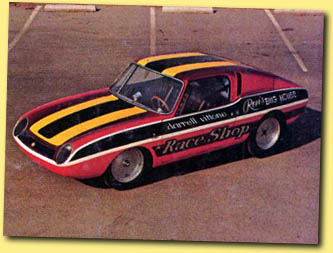

"What does it take to stay competitive in drag racing? Ask any hardcore racer and you will get a reply like " a helluva lot of work and plenty of luck". The competitive racer spends hours of research work striving to get the lowest ETs to stay ahead of hundred other guys trying just as hard to do the same thing. it's a never ending battle on two fronts, the clocks and the competition and it's not limited to the fuel burning Dragster or Funny Car builders, either. It's just as dificult, if not more so, to refine an exsting factory-built machine to make it a better drag racer all the while staying within the limits of the very stiff NHRA Rule Book.
Darrell VITTONE has been connected with high performance Volkswagens for a good many years and his EMPI Inch Pincher VW Gasser is well kwown to anyone with an interest in drag racing. Untila short time ago he track tested EMPI speed parts in this company sponsored race car.

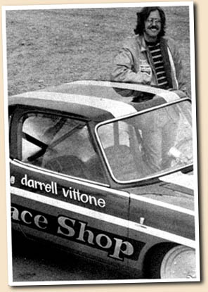

Nnow there's a small shop in Riverside, California, simply named THE RACE SHOP. It's a speed shop designed to make VW-powered cars go fast, and it's Darrell newest endeavor. To christen his new enterprise, Darrell started out to build a strong race car. He was free to pick and choose because he was no longer tied to the VW as the car he must campaign. However he wanted to saty with a VW powered machine bacause he knew this engine best. To fit the needs of superfast H/Gas drag sedan, he looked for something with better aerodynamics than of the Beetle sedan. Even with a 4 inch top chop to make it a better drag machine, there just had to be a slicker way to go.

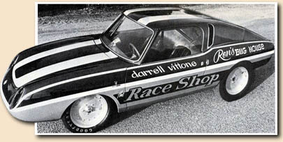

To comply with NHRA rules, the engine must remain in the same location as it was originally. At first a rear-engined small sedan better than the Beetle seemed nonexistent, but there was the super smooth little Fiat 850 Spider. The only drawback was that to race in a NHRA class, it must be a hardtop class, no open cars. But there is a fiberglass top that can be fitted to this model that would qualify it as H/Gas class material. It wasn't difficult for Darrell to decide that his new car would be a hardtop Fiat 850 with the strongest VW engine he could put together nestled in the rear.
Looking at Darrell's new wildly painted drag machine, it is hard to imagine it was once a stock street driven roadster with all the regulars like bumpers, wipers... Leon SCHINDELE of Riverside takes credit for the magnificent job of reworking the Spider's exterior, filling all the holes that existed when the parts were removed.
SCHINDELE also worked the 'glass top to get it as smooth as the metal body. It is evident that much time and hard work was put into the car getting it ready to paint. Credit for the paint goes to the wild car paint artist, Georges CERNEY of Norco.
He was a way of using a startling assortment of bright colors and making them really come on. The car sports lot of orange and red and some bright yellow, very dark burgandy, shades of purple, and white. And it's bright.

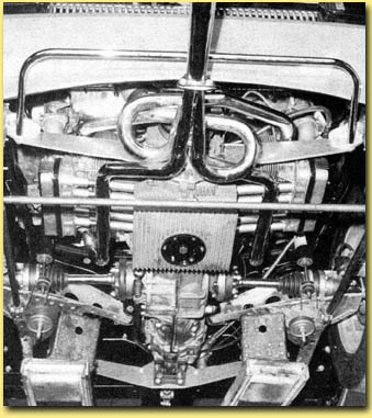

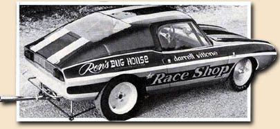

Most of the chassis work was done by Charles MORSE. First the entire stock Fiat suspension was removed. Up front the stock A-arms and its complete suspension was replaced with a much lighter set-up. For strenght and simplicity, they decided to use a Funny car tubular axle and a dragster-type torsion tube. The funny car axle was originally built by John BUTTERA but Charles cut it in half and narrowed it 6 inches to fit the 850 body. The torsion tube was made up with brackets to attach it to the lower edge of the chassis rails. The housing was fitted with a shortened VW torsion bar and special arms attach the bar to the reworked axle.
Small KONI shocks are used but are held to a limited travel of 3 inches on the front suspension. The steering bos is the stock Fiat rack & pinion unit mounted in its original location.
At the rear, the stock Fiat control arms were retained but heavily strenghtened to absorb drag racing punishment. The unit were lightened considerably by drilling and all of the seams were heliarc welded for added strenght. The stock coil springs were retained but have a long snubber bolt running trought them for travel control. The rear suspension is set up with one inch of travel as required by NHRA rules. Bilstein gas-filled shocks are used in the rear and have been relocated."

Here are the Tech Specs as they appeared in the Hot VWs feature of the Fiat 850 way back in 1973...
Enjoy this mega rare color picture! ;)

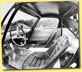

- Body : All steel 1967 Fiat Spider with fiberglass roof, wooden decklid, and plexiglas windows, Tom Hanna Aluminium interior.
- Paint : Multicolor lacquer by George Cerny.
- Seats : Custom racing seats by Al Taylor.
- Chassis : Unibody.
- Running Gear, Suspension : Dropped tube ffont axle. Fiat steering. Koni front and rear shocks, coil spring rear suspension.
- Transaxle : 1970 Porsche with custom axles using the Fiat stub axles and Fiat 124 disc brakes.
- Wheels, Tires : Cragar aluminium wheels in front, Deano Dyno Soars in rear with M&H 6.60-15 slicks.

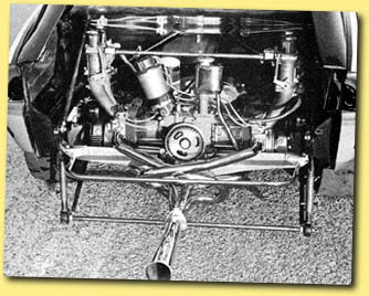

- Engine : 1971 VW with 84mm stroke and 89mm bore, total displacement 2090cc.
- Barrels & Pistons :Mahle
- Crankshaft : Okrasa, stroked by Gene Berg.
- Camshaft : Engle F-32.
- Cylinder heads :1971 Dual Port with 40mm intake valves and 36mm exhaust.
- Valve springs : Dual EMPI.
- Rocker arms : EMPI 1:1.4 Ratio.
- Cylinder heads modification : Milled, Ported and flow tested at the Race Shop.
- Intake manifold : EMPI.
- Carburetors : Dual 48 IDA Webers
- Exhaust header : The Race Shop.
- Clutch - Flywheel :The Race Shop 180mm clutch and disc.
- Ignition : Vertex Magneto by Joe Hunt.
- Spark plugs : Champion L3G.
