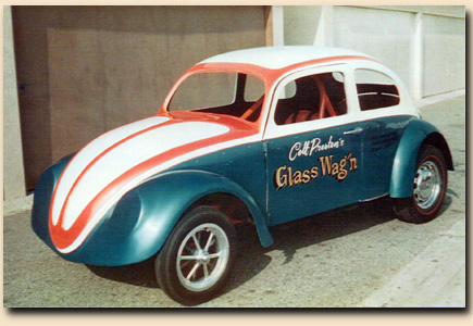

Quite probably one of the very first picture of the Glass Wag'n... Note the red rollcage and the lack of any racing stickers... Should be the very very early days... Note the lack of running boards and side chrome trims...

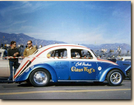

This is another early picture of the bug because it doesn't had yet the yellow drag chute... Exact location is unknown but Casey is guessing it was at Irwindale Raceway... Casey is standing behind his car with sunglasses.

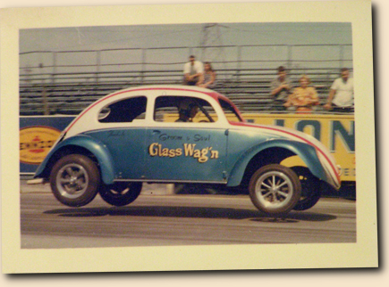

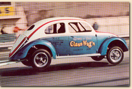

After Casey sold the car in late 1967 to Raymond GROOM and Bill SAUL from Lakewood, California, this is typically how you might see the Glass Wag'n when racing : All 4 wheels off the ground, 2 feet in the air, as shown here at Lions Dragstrip... Note the Groom & Saul names on the doors in place of Colt PRESTON...
Casey recalls : As far as lifting all four wheels, when I sold the Glass Wag'n, it had a transmission that I built, but the buyer destroyed it in a race and installed a bus trans. When he installed the bus trans he did not adjust the spring plates. Therefore, when he launched, the car would leap off the ground. When this was discovered, he would make 3 runs a night at Lions Dragstrip for $50.00 a pass.

Groom & Saul days... Note the typical front end stance...

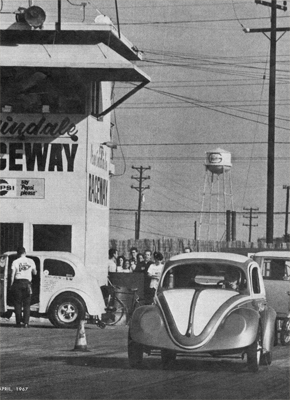

Hard launch at Irwindale Raceway...

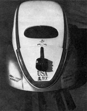

Rear view reveals the parachute and the 'Paint by Molly' famous logo just under the rear window...
